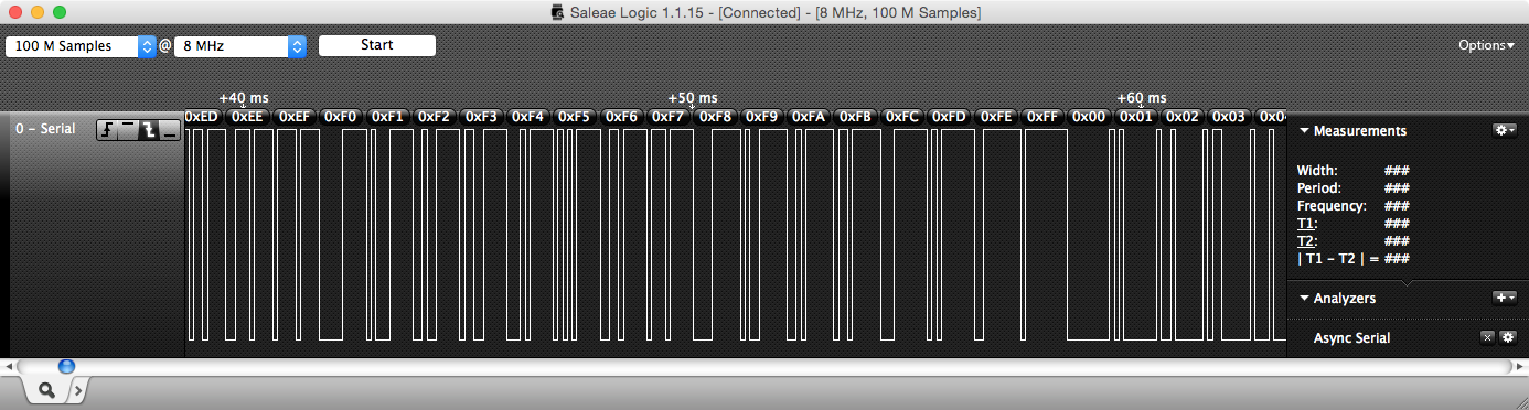

For just in case, I tried next code on mbed LPC1768.
It seems the output is fine.
Serial serial( p28, p27 );
int main() {
char c = 0;
while( 1 ) {
serial.putc( c++ );
You can use putc to send and getc to receive any character from 0x00 to 0xFF over a serial port. Same with pc.putc to send data to the PC.
