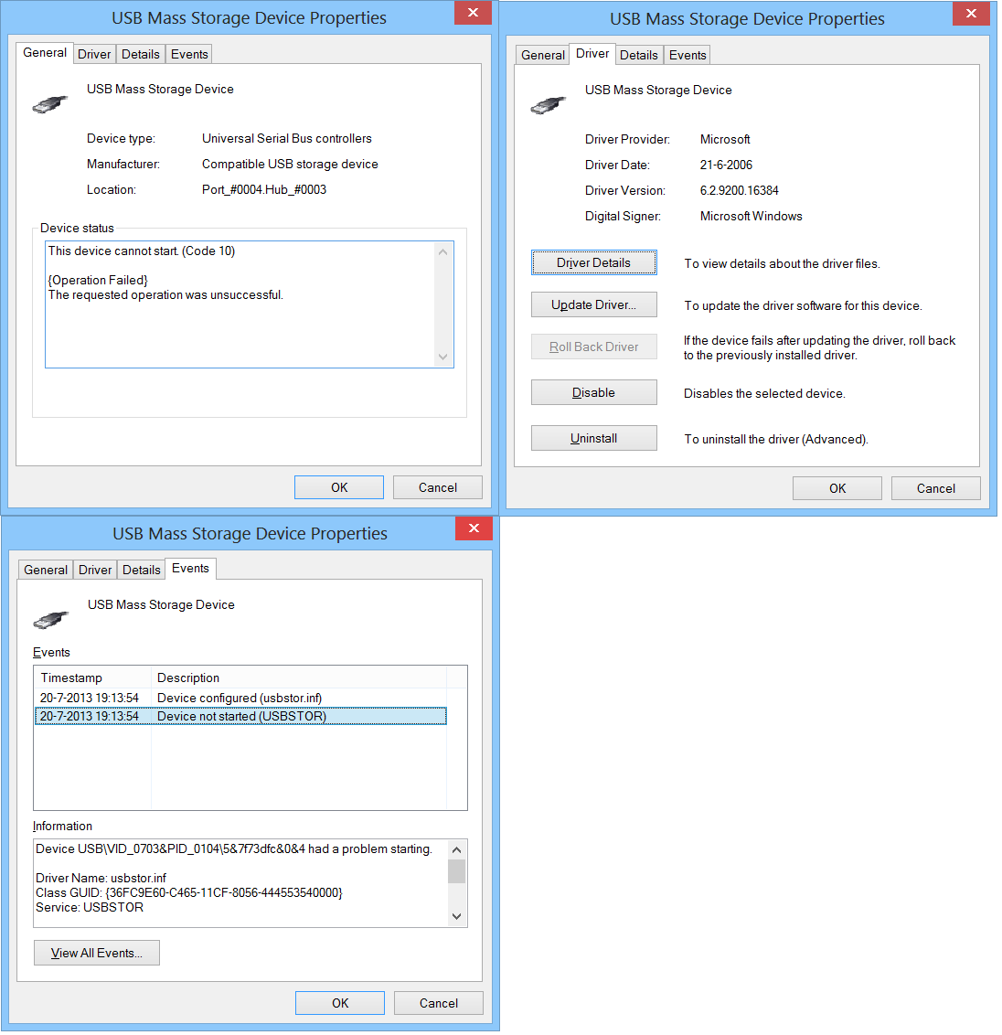

As the title says, I have an issue that it doesn't look I can solve myself. The USB port of the KL25Z does not function on my laptop. The openSDA port works fine, but the one connected to the KL25Z itself does not. I tested it with MSD, serial and usb mouse, everytime my windows 8 laptop (Asus N56z) says something went wrong. I also put it in a windows 7 desktop computer, and there it worked fine.
I manually uninstalled its drivers, plugged it in again, it installs drivers again, and same result. I tried the same code on an LPC1768 mbed, and that works fine. Also tried changing VID/PID, didn't help either. I tried pretty much every USB cable I have here, including a very short one, no result.
What windows shows in device manager:
It is a bit random for MSD if it shows it as an MSD device, or just unknown device.

I could loan a USB 2.0 hub today, and with that it worked fine: apparantly it solves whatever issues caused the problem: Now it works fine. I assume Frank's explanation is correct and it is due to an issue between the KL25Z and the USB3.0 controller.
However, I think the interface chip uses the same USB peripheral, maybe a different revision, but for whatever reason, that one works. And while as hobbyist this solves for me the problem, if you want to make a product with the KL25Z it is not really a solution to add a USB hub. So I do wonder if the interface chip uses different settings for the USB peripheral as the KL25 USB device code, sadly that is not possible for me to figure out :).
