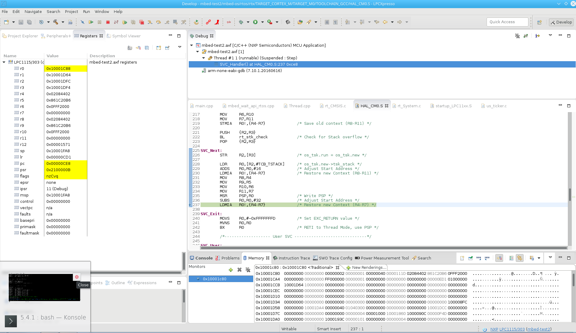

I have set up a debug session in LPCXpresso with the led blink example.

Here I have a reproducable hard fault:
SVC_Next:
STR R2,[R3] /* os_tsk.run = os_tsk.new */
LDR R0,[R2,#TCB_TSTACK] /* os_tsk.new->tsk_stack */
ADDS R0,R0,#16 /* Adjust Start Address */
LDMIA R0!,{R4-R7} /* Restore new Context (R8-R11) */
MOV R8,R4
MOV R9,R5
MOV R10,R6
MOV R11,R7
MSR PSP,R0 /* Write PSP */
SUBS R0,R0,#32 /* Adjust Start Address */
LDMIA R0!,{R4-R7} /* Restore new Context (R4-R7) */ <- HARD FAULT on that LDMIA --<

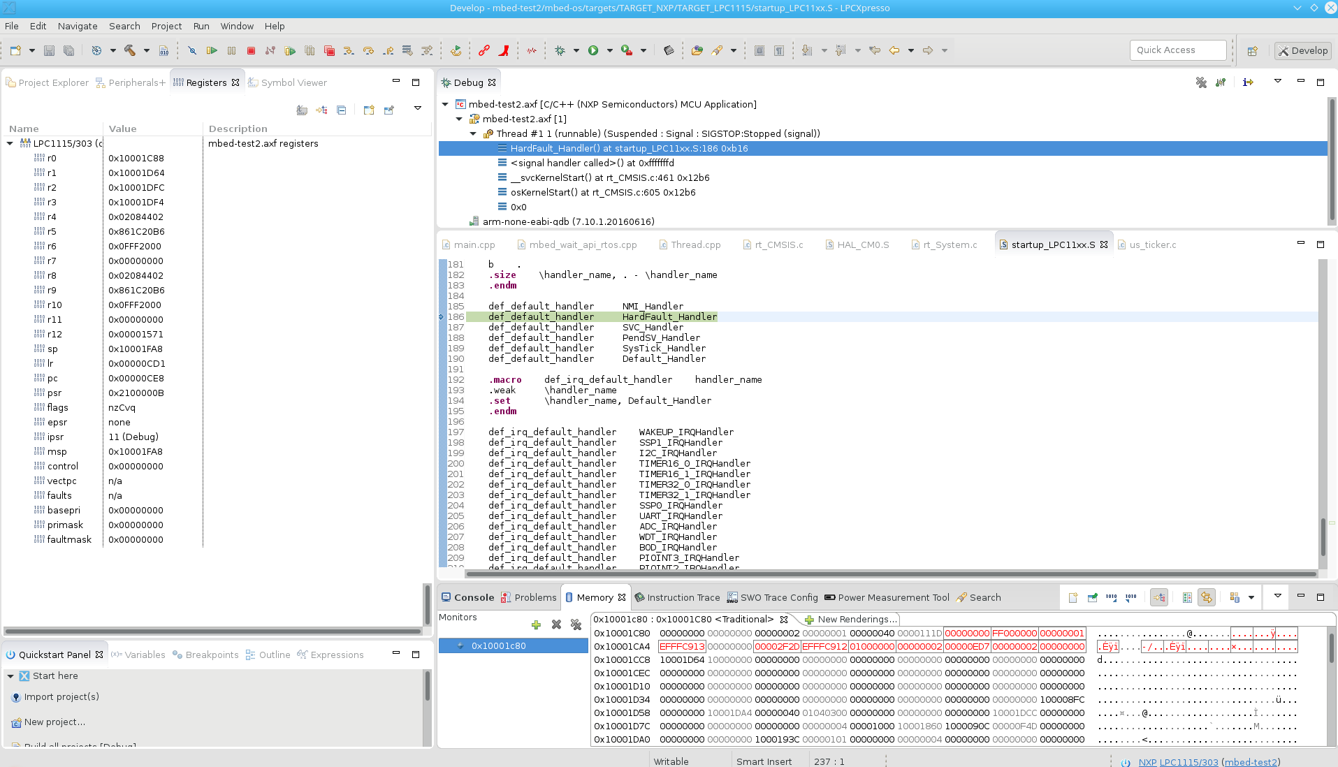

So the SVC_Handler is executing the os-call (svcDelay()) correctly, returns back to the SVC_Handler and at the end of the Handler the hard fault occurs.
I attach two images from my debug session with all register and memory values, one before the ahrd fault and one after.
It would be great, if anyone can give me a hint, how to track down that.
