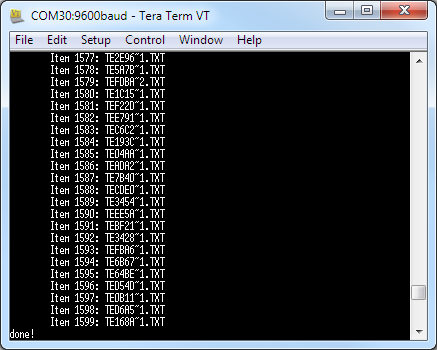

To reproduce the bug, I created a folder on an SD card with 1600 files in it. The test program scans the folder without using the list first, in order to prove that this isn't a FatFs-related stack overflow:

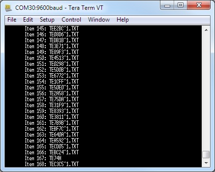

Then it scans the folder again using the list, and inconsistent memory corruption ensues! This particular run crashed gracefully at index 155:
This run, however, deadlocked after reading index 168:
Am I doing something wrong here? How do I even begin to troubleshoot this?
