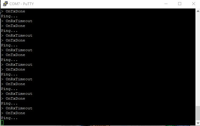

As you can see I have only changed the MISO, MOSI and SCLK mappings here. I have rewired the modules respectively for this change also. The ping seems to work, but I get RF timeout
I figured it out. It was due to the RF_FREQUENCY not being set to the proper 433MHz for the InAir4 module.
