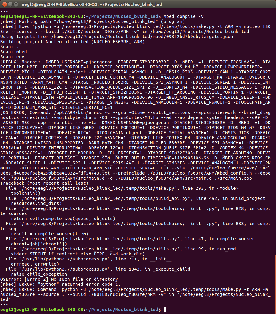

I've tried a few different example projects and I keep getting the same error. It says "No such file or directory" but doesn't specify what it's referring to.

Solved! Needed 32-bit libraries installed:
sudo dpkg
posted by Phillip Bergeron 31 Mar 2017add-architecture i386 sudo apt-get update sudo apt-get install libc6:i386
