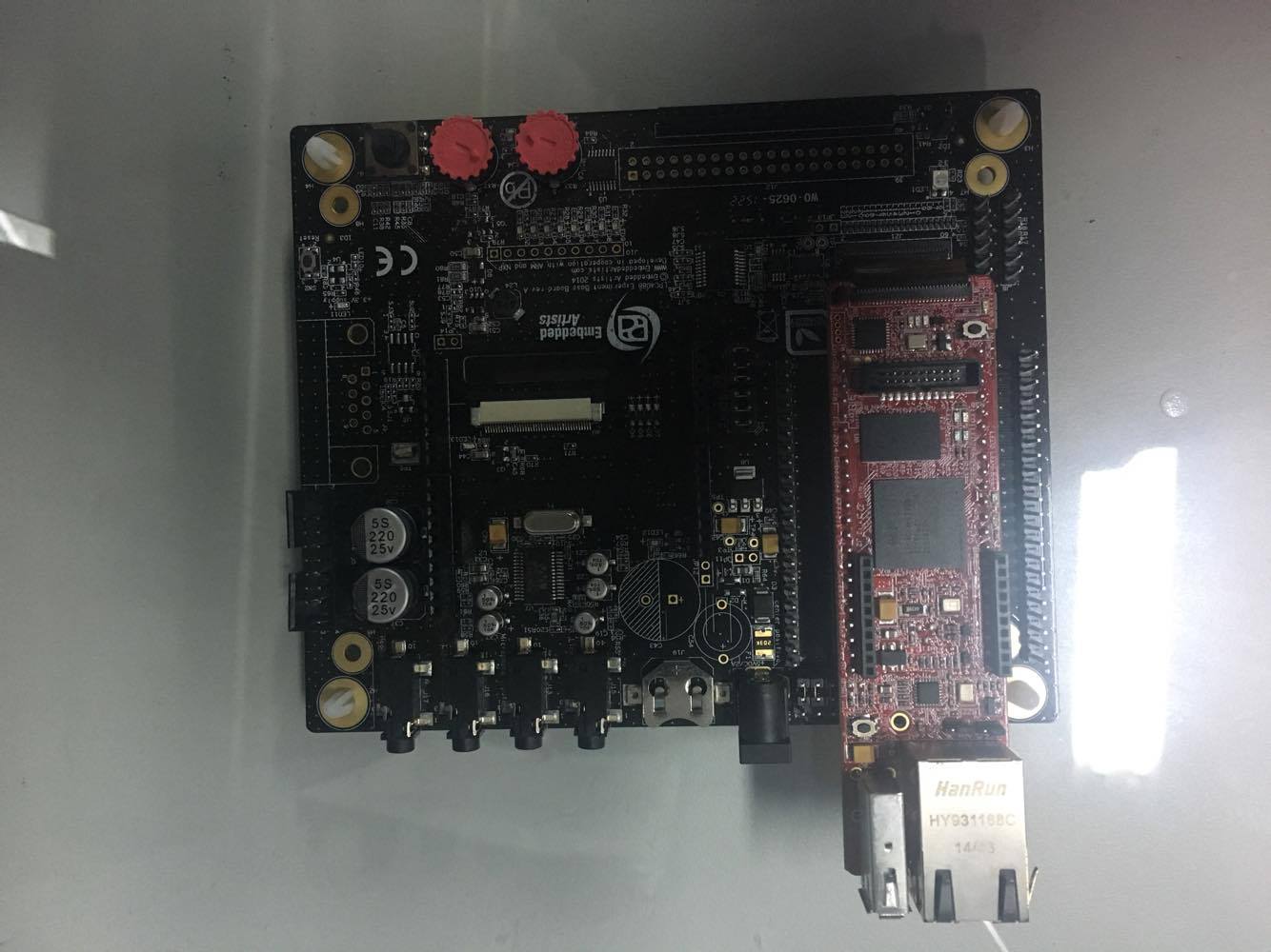

i have a problem about LM75 Is it on the LPC4088 board or i need to buy it ? /media/uploads/david8251/14875799_1456918897658137_1367991063_o.jpg
i use i2C (P28、P27) the putty always display pinmap not found for peripheral
so if i buy LM75 and connect it to LPC4088 it will solve? or it has another problem?

Hi,
According to the schematics of LPC4088 Experiment base board, an LM75 sensor on the board connected to P1_30 and P1_31 ports which are corresponded to p19 and p20 pins. Therefore, you need to have following definition:
I2C sensor(p19, p20);
or, you can also specify port names as below:
I2C sensor(P1_30, P1_31);
I hope this helps.
