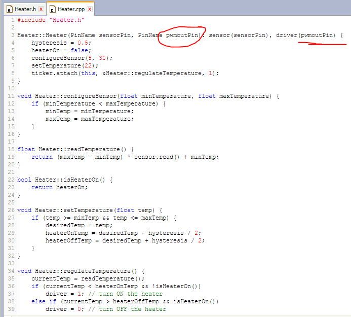

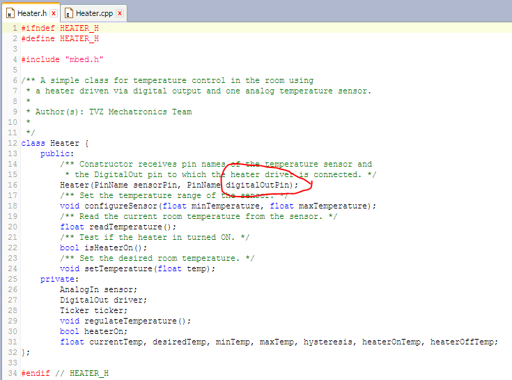

u Heater.h je driver definiran kao digitalOutPin ,dok je u Heater.cpp kao pwmoutPin. Greška ili ?
9 years, 8 months ago.
Not a problem. The "name" that you see is not a pin-type declaration. It is just a variable name which is used to represent the physical pin number.
The actual pin-type will be declared in the "driver" routine.
