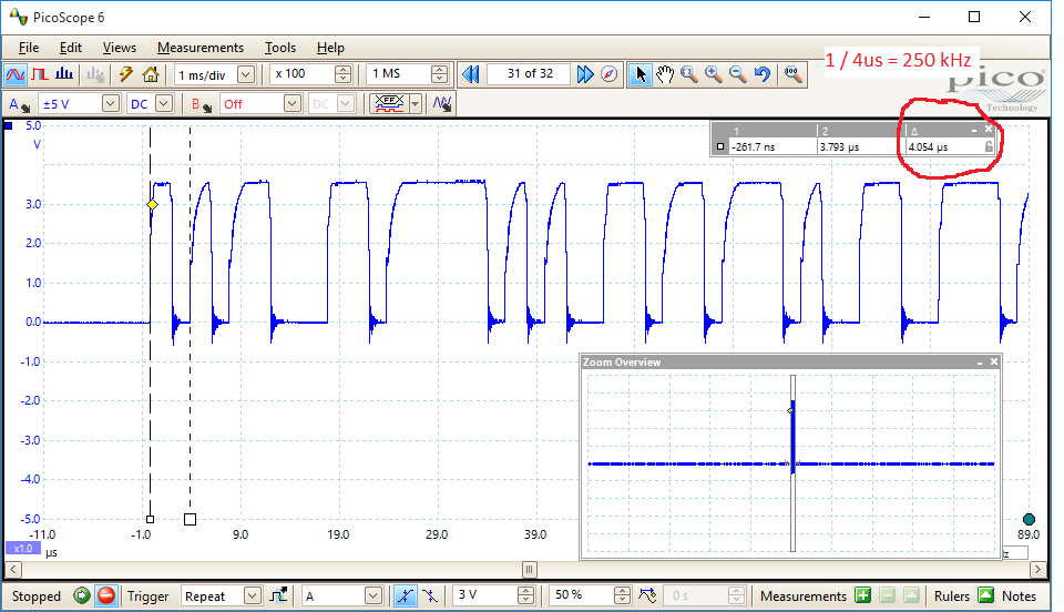

It worked straight away, surprisingly. The next thing I wanted to do was set the frequency to 500 kHz, since I believe that's what the OBD-II connector on my 2009 BMW uses. So, I modified the program from the page linked above by adding:
if (!can1.frequency(500 * 1000) || !can2.frequency(500 * 1000)) fatal_error("Couldn't set freq\n");
The program still works but I wasn't sure what units or range the frequency function accepts, so I verified the output with my oscilloscope. It seems to me that the frequency selected was actually 250 kHz.
Have I misunderstood or done something wrong?
I don't know if this comment is still relevant, but the signal you are showing there has a frequency of 500kHz : You get 2 differents bits (1, then 0) in between your cursors, indicating that it took 4 µs to send 2 bits -> 2 µs to send 1 bit -> 500 kbits/s baudrate The frequency would be 250Khz if you where looking at a square wave, which is obviously not the case. In terms of serial transmission, it's more accurate to use bits/s instead of Hz.
