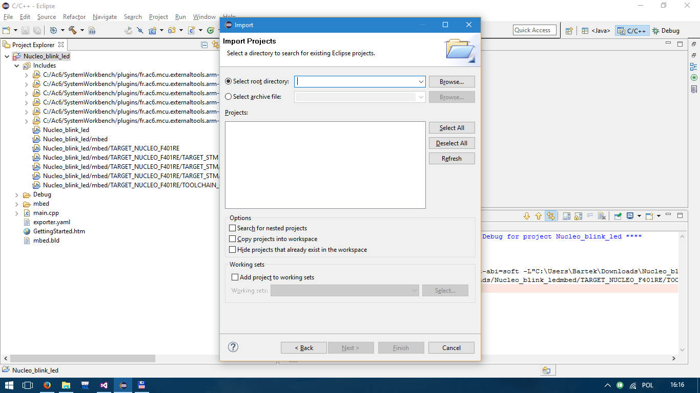

Hello Everyone! Im trying to import simple project from mbed compiler to sw4stm32 and i got stuck. Im trying to do this in this steps:
  • 1. Export from mbed compiller, i choose in export window SW4STM32
  • 2. In SW4STM32 File -> Import -> Import existing project into workspace. /media/uploads/bmajkut/zrzut_ekranu_2016-05-25_16.16.04.png

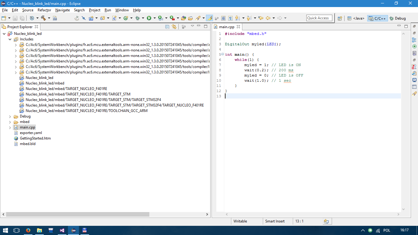

  • 3. After that i get project imported into SW4STM32 /media/uploads/bmajkut/zrzut_ekranu_2016-05-25_16.17.40.png
  • 4. When i try to build this project i get something like that:
make all
'Building target: Nucleo_blink_led.elf'
'Invoking: MCU G++ Linker'
arm-none-eabi-g++ -mcpu=cortex-m4 -mthumb -mfloat-abi=soft -L"C:\Users\Bartek\Downloads\Nucleo_blink_led\mbed\TARGET_NUCLEO_F401RE\TOOLCHAIN_GCC_ARM" --specs=nano.specs -T"C:\Users\Bartek\Downloads\Nucleo_blink_led\mbed\TARGET_NUCLEO_F401RE\TOOLCHAIN_GCC_ARM\STM32F401XE.ld" -Wl,-Map=output.map -Wl,--gc-sections -fno-exceptions -fno-rtti -lm -o "Nucleo_blink_led.elf" @"objects.list ...
arm-none-eabi-g++: error: C:/Users/Bartek/Downloads/Nucleo_blink_ledmbed/TARGET_NUCLEO_F401RE/TOOLCHAIN_GCC_ARM/stm32f4xx_ll_usb.o: No such file or directory
make: *** [Nucleo_blink_led.elf] Error 1
  • 5. I found that this line:
Is the wrong line because there is
C:/Users/Bartek/Downloads/Nucleo_blink_ledmbed/...
and should be like this: <<code> C:/Users/Bartek/Downloads/Nucleo_blink_led/mbed/... <</code>>
Ive tried to find this line in makefile and any other files in this project but there isnt such thing. Does anyone have any idea how make it works?
