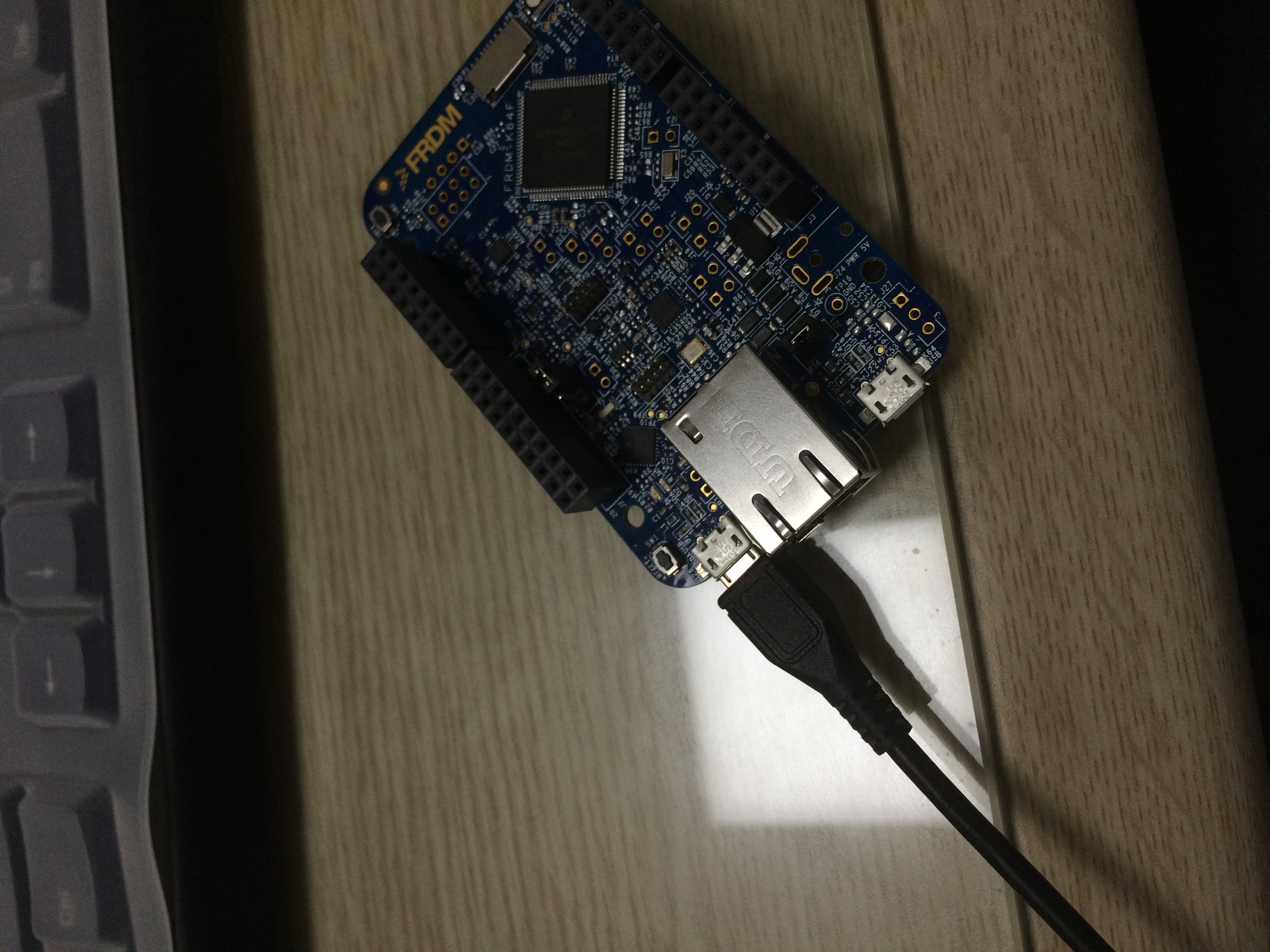

FRDM-K64F is not power-on. anyone know to recover this board.
actually. I just got the K64F board. and I was gonna set the debugging enviroment for a 30minuate ago.
so, plug in the Power/OpenSDAv2 Micro USB Port with micro USB from ubuntu 14.04 on my laptop
for the board was booting as a 'bootloader' mode for debugging and then input the binary file.
the board was boot after complite copy in the board.
the board is not working. never turn on.
how can i do that?
10 years, 10 months ago.
If you keep button pressed while plugging the usb cable, the board should go into bootlader mode, wher eyou can recover the interface imagine (look at platform page for K64F), where are instructions.
