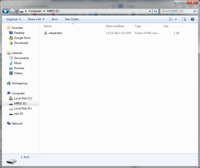

I have attached 2 images. /media/uploads/GabrielSoare/1.png This is when the program is loaded and it is working.

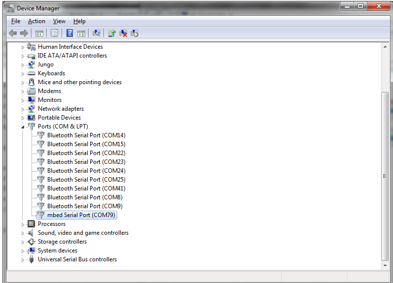

/media/uploads/GabrielSoare/helloo.png
when the board has erased my program.

First of all, what you see regarding the file being removed is intended behavior: it doesn't store the current firmware on the interface IC, so it programs it, and doesn't store it.
That your program doesn't properly work is of course not intended behavior. However looking at the name of the drive it is still running the original firmware, which expects a different type of files (hex I believe instead of bin). Here is the firmware upgrade procedure: http://mbed.org/handbook/Firmware-FRDM-KL25Z (the upgrade procedure works best on windows 8.0 and earlier, but it looks to me like you got windows 7, so that shouldn't be a problem).

as Erik noted, the original P&E interface accepts only .s19 files, therefore it does not work out of the box with binaries.
Update the firmware (follow the instructions in the link Erik provided - firmware) to mbed CMSIS-DAP.
