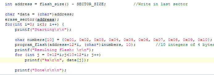

hi there, very thanks for your help, but if i try to write some hex message to flash like this /media/uploads/senseHuge/2.png the address must be set to 12, when i use keil to debug it , it seems that it will put 2 '00' to the end of '0x10' , I don't know why this happened.

How do you mean that the address must be set to 12? flash_size()-SECTOR_SIZE calculates the start of the last sector you have in the flash, so the one most likely to ne available.
Your result is (roughly) correct. Maybe I should add a check for it and return an error message, maybe I should keep the current behavior (please respond what you think is better).
The issue is the length. You can only write flash in blocks of 4 bytes (at least on the KL25). It was intended that if you try to write something which isn't a multiple of 4, it returns an error code, but it seems that never made it in. Now it simply writes to the closest multiple of 4, and does that by continuing reading after the end of the 'numbers variable, which by default is 0 (if you put another variable right after 'numbers' it will write that one).
So you need to write in multiples of 4 bytes. I can either make it refuse to write another length, or I can just keep it similar to this, where it adds dummy bytes to get it to a multiple of 4 bytes (I am leaning to that one).
That said, does it matter for you that it puts 2 times 0x00 at the end? It stores your 10 variables, at interfalls of 12, as you told it to do. What it does in between shouldn't matter I think?
