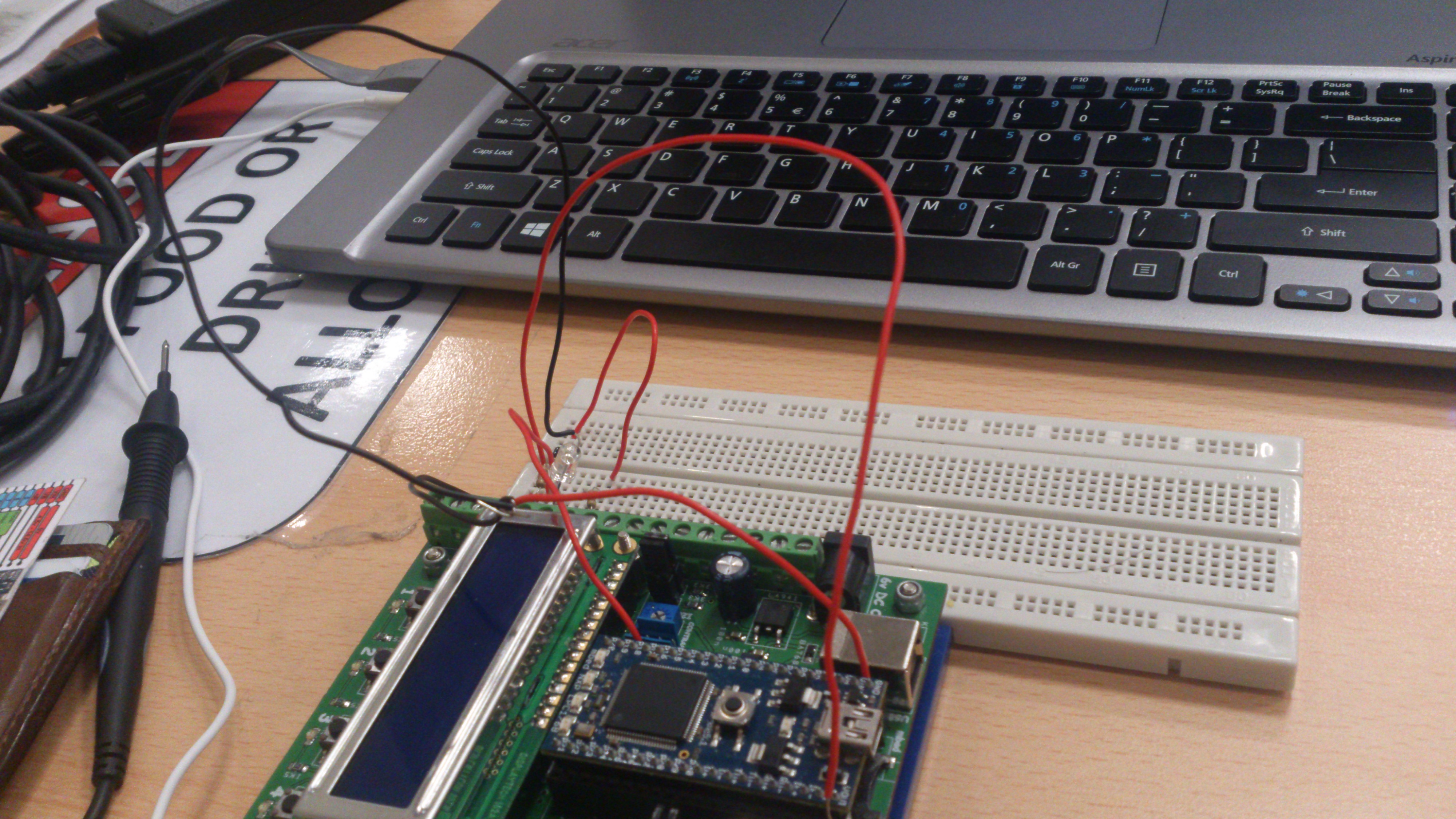

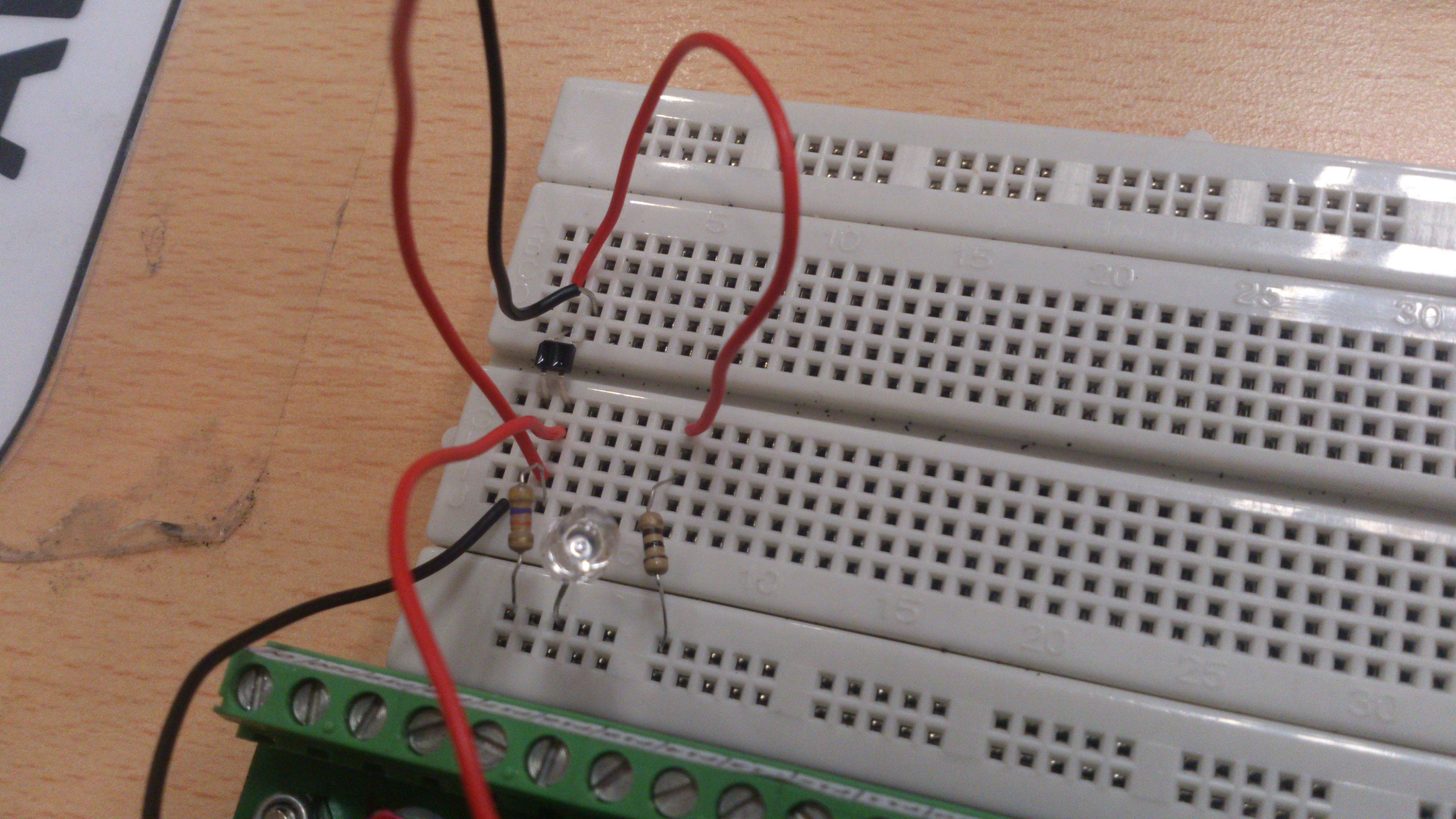

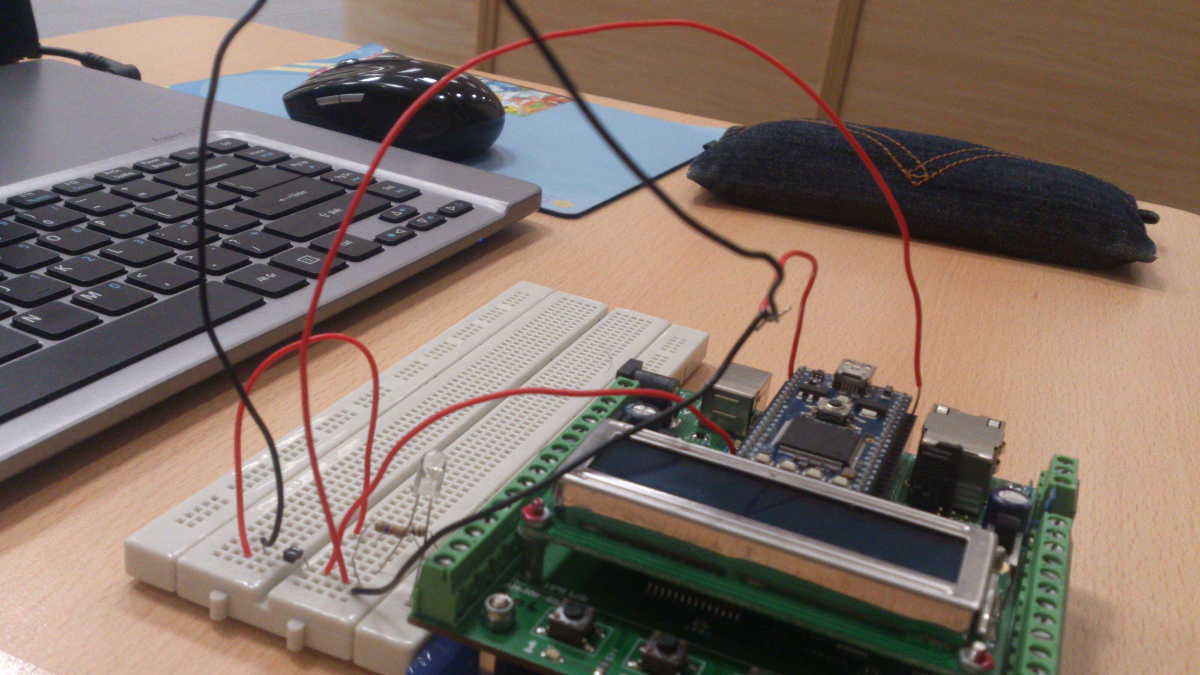

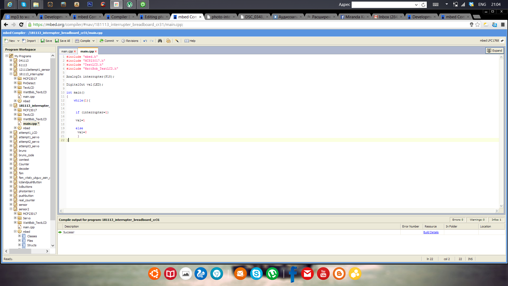

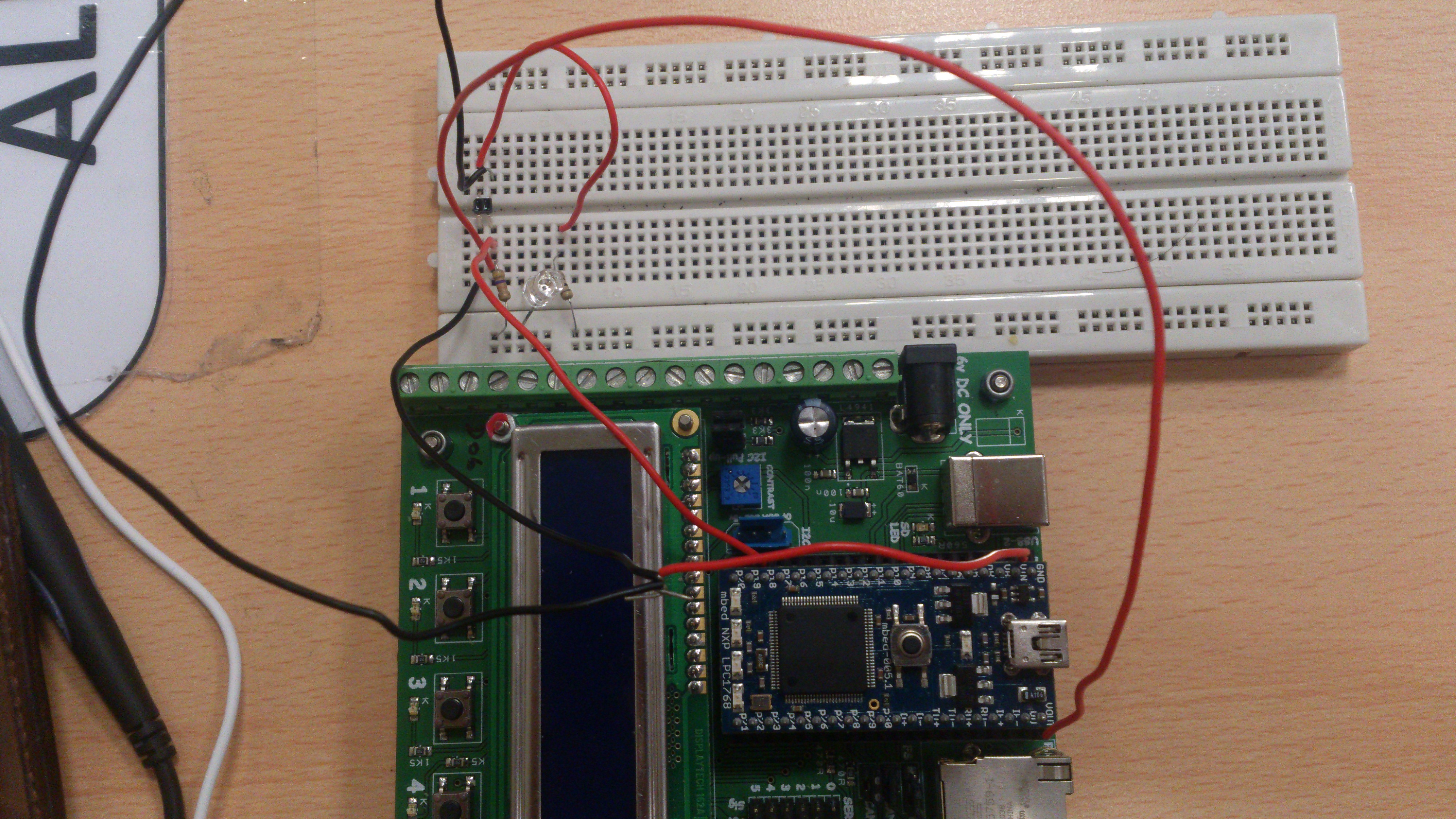

Can anyone identify what is wrong with my code or with my wiring?
I want to get LED glow when I am moving my hand above the photo interrupter

I didn't check your wiring, pins, etc. But for sure there are two errors in your code: First of all you use '='. To check if something is equal always use '=='. Next you use AnalogIn, which returns a value between 0 and 1, so it makes more sense to for example check if it is larger than 0.5.
Also consider just sending the input value back via the PC Serial connection, then you can see which values are read.
