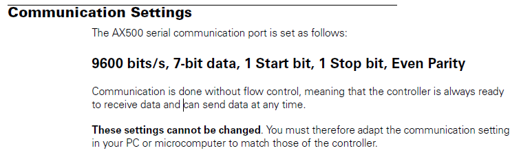

Now I wonder if the 'start bit' is causing the problem because the mbed Serial port doesn't mention anything about 'start bit'.http://mbed.org/projects/libraries/api/mbed/trunk/Serial#Serial.format
Heres the pdf manual for the ax500 for RS232 mode. Page 104 is where the communuication settings are at. http://www.roboteq.com/files_n_images/files/manuals/ax500man19b-060107.pdf
